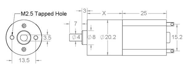

Dimension Diagram for the 25:1 and 67:1 versions
The picture below shows the dimensions (in mm) of the 25:1 and 67:1 versions of our 20D mm line of gearmotors. The value of X is 18.5 mm for the 25:1 20Dx44L mm version and 20 mm for the 67:1 20Dx45L mm version
25:1 and 67:1 20D mm metal gearmotor dimensions (units in mm). Note: this diagram only applies to the older and now-discontinued 25:1 and 67:1 gear ratio versions.
